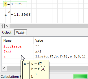

  • Initial implementation of the built-in debugging tools completed (set breakpoint [Ctrl+F8 or context menu] and recalculate a worksheet);
  • Pause button is available on main toolbar now - it allows to pause calculation and see an exact place where calculation is in progress;

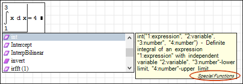

  • Plug-in name included into the Tooltip for functions/variables/operators;

  • Context Menu with Copy button implemented for the list in Watch panel;
  • Fixed issue when unwanted selection appeared sometimes on debugging;

  • Tooltips implemented for items in Watch panel;
