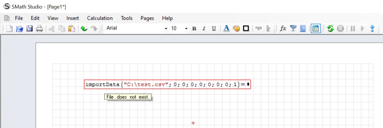

and enter to the SMath Studio importData function:
but there is an error "File does not exist". I changed function arguments as you can see at https://en.smath.com/forum/yaf_postst539_importData-and-exportData.aspx , but there is no effect.
What's wrong with my file?
Version Smath Studio 0.99 (build: 7579).

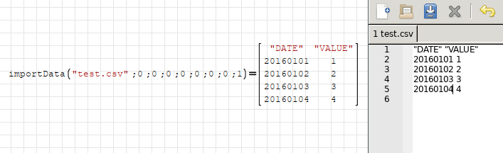

I couldn't recreate the problem.
Everything seems in order.
Tested under linux.

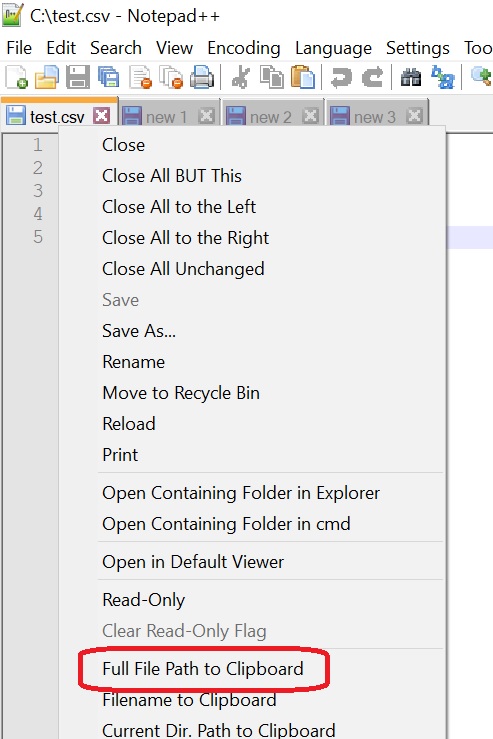

I copied path to my file with context menu of notepad++
So when I paste path to Smath I can't see difference between manual path input and copy-and-paste it. Picture is the same. But when I copy formula back to the clipboard - it's differ when I get it:
