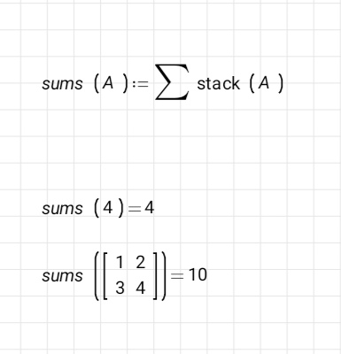

#5 Posted: 4/18/2022 10:22:36 AM
1,430 likes in 2,889 posts.
You're welcome
Note that using the stack approach you don't need the zero
