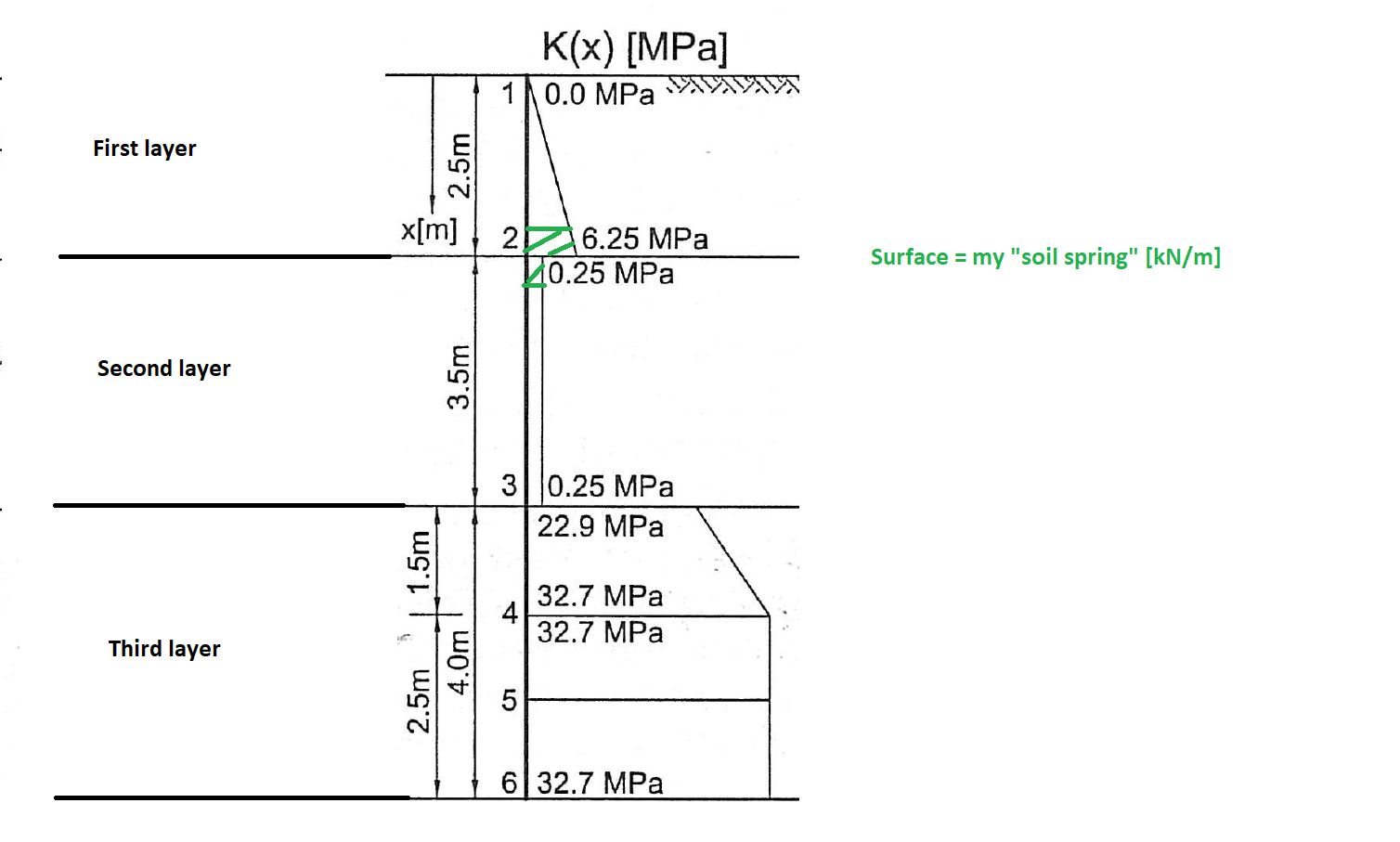

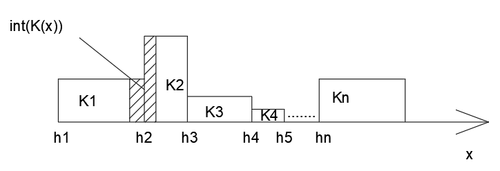

I'm trying to write a function that I can use to calculate the surface area. The function is to be based on data from a matrix with n elements
I ran out of ideas. I guess the problem is in a loop.
I attach a file and an image.
I will be grateful for your help.

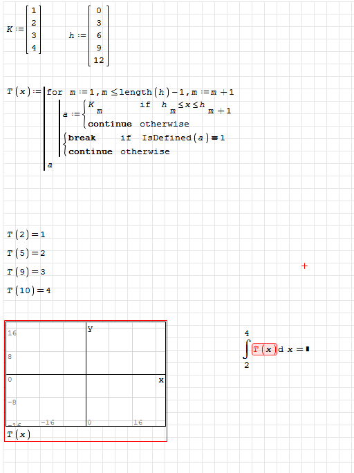

You can define piecewise function this way. Haven't figured out integration yet. Built in int() function doesn't seem to work.
Piecewise Function.sm (6.82 KiB) downloaded 1134 time(s).

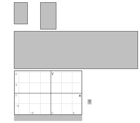

Latest version is all white. Could discover the blank regions,
framed the regions, added background.

Thank you guys for your answers,
I will try to explain what I need.
Depending on the soil layers, I have a graph similar to the picture. At a later stage, I want to divide this chart into equal pieces (for example 0.25 m or 0.5m) to obtain "soil springs".
To simplify the example, I assumed that the elements of the K matrix are constant.

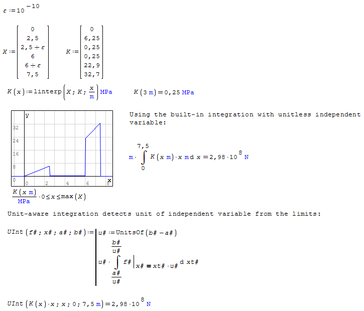

#9 Posted: 9/21/2019 5:47:47 AM
1,361 likes in 2,275 posts.
uint.sm (9.71 KiB) downloaded 1145 time(s).

OK ... from there, apply your skill to produce the Cartesian graph
of the piecewise soil. No problem to integrate.
Integration of discontinuous functions is deceiving.
Two models attached. The Romberg-Simpson is more accurate.
Example 2, the integration is known by inspection.
Isn't deceiving Simpson is not so good !
Integrate Discontinuous_2.sm (131.93 KiB) downloaded 1187 time(s).

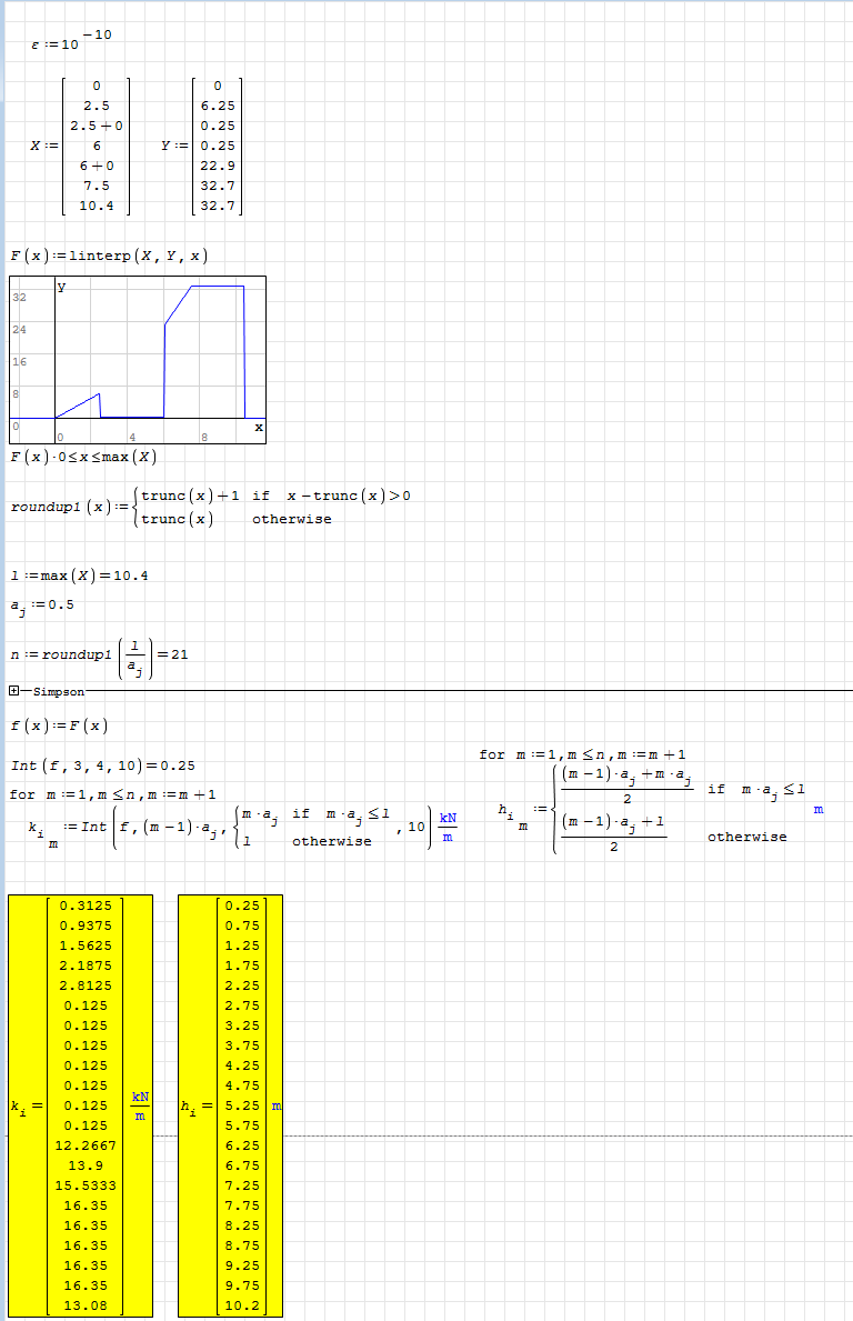

Thank you very much,
(btw the "thank" button on this page does not work)
The idea of ​​using linterp is actually much better instead of a loop.
Below is the file with the result I needed.
Final springs.sm (20.64 KiB) downloaded 1169 time(s).

The "Tanks" button used to work years ago, not any more.
Good work ... two comments:
1. subscript is confusing with sub-sub index.
Very many projects are sub-sub indexed.
Reserve subscript as tutorial [exemplified].
2. variable name confusing with number is another killer.
you had 1:=max(X).
SS7030 was reputed good version, compatible SS 6179.
Final springs_1.sm (24.73 KiB) downloaded 1165 time(s).
