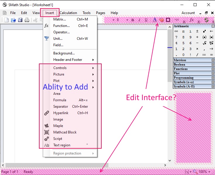

I am curious: outside of being able to add controls to the 「Insert」 Menu (via IPluginCustomRegion.GetMenuItems); can a plugin add custom Toolbars or interface with the Status/Title Bars?
I am familiar with the ability to add a context menu item (via IPluginCustomRegion.GetContextMenuItems), as well as the ability to create/launch a customized Windows Form (e.g., InputBox, Msgbox, etc.); I am more or less focusing this question with regards to those areas as indicated in my image.

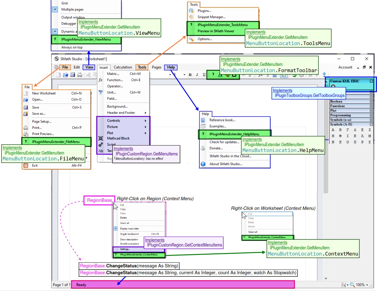

As for the Toolboxes, you can add new groups using the IPluginToolboxGroups interface (see f.e. CustomFunctions plugin)
Since a while you can add new items even in other places than the Insert menu using the MenuButton.MenuButtonLocation property (see f.e. SimInTechCalcDataManager).
Using RegionBase.ChangeStatus you can display messages to the statusbar (see f.e. SnapshotRegion), and obviously there is the trace window too using Store.TraceData(string).
About custom Toolbars a long time ago I've played a bit with this idea and made an interface, but it worked nice only in Windows, so since in mono everything was messsed up I've abandoned it.
I guess that now with the ribbon menu in SMath Writer would be more feasible to have something valuable.

The follow-up question I would have is this: Any ability to influence the sort/order of placement within these toolbars/menu item?
Since I am a visual person, I took the liberty to highlight the areas a Plugin is allowed to mount within the GUI (per Windows Application); Please let me know if I overlooked an area/feature:
