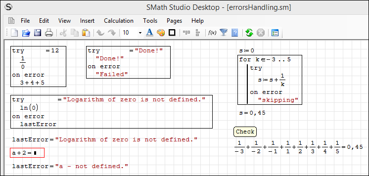

  • SS-2314: Function try(..) implemented;

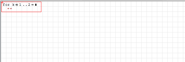

#4 Posted: 4/16/2016 8:59:52 AM
Mike Kaganski
Mike Kaganski
184 likes in 434 posts.
No problem - that's what nightlies are for.
Other problem: error description (and lastError) seem to be in OS language, regardless of SMath UI language.
E.g., in my Russian Win10, SMath UI is set to English, but for an erroneous block, I get error text "В экземпляре объекта не задана ссылка на объект.".
С уважением, Михаил Каганский

#6 Posted: 4/16/2016 9:22:44 AM
Mike Kaganski
Mike Kaganski
This is exception which is not handled correctly. That is why error is meaningless and not localized.
Please explin how can I reproduce it.
Page8.sm (1.8 KiB) downloaded 1918 time(s).

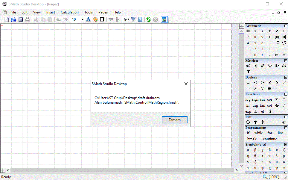

#8 Posted: 4/16/2016 4:31:16 PM
598 likes in 1,380 posts.
Smath Studio 0.98.5950 creates "MathRegion.finish" error for several worksheets of mine and files couldn't be opened. Same files have no error at version 0.98.5932 and perfectly opened. I have uninstalled 5950 and installed 5932 with same plugins and there were no problems at all.
As far as I witnessed I can open ".sm" files partially by disabling the plugins. The problems for my files are CheckboxList, ComboboxList, RadiobuttonList, WriterRegion plugins.
#9 Posted: 4/16/2016 9:21:33 PM
1,443 likes in 2,935 posts.
I've updated these 4 regions for this SS version (many thanks to Andrey for the help via skype); let me know if you notice other issues.
P.S. WriterRegion is relased as Beta, it contains also several minor fixes not related with this SS update and a new option to choose when to popup the toolbar (Options > Environment). If all it works fine I'll relase these things also for previous versions of SS.

#10 Posted: 4/17/2016 12:20:20 AM
thank you for quick return, now it seems all plugins work as they are supposed to be.
