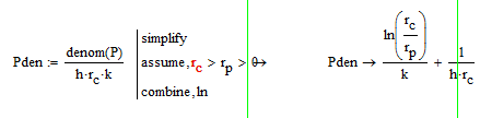

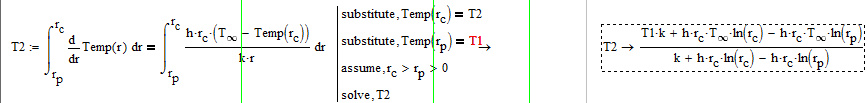

I would love to see an symbolic keywords. Being able to use Mathcad type parameters such as substitute, assume, solve, simplify, combine ... etc., would round out SMath.
Maybe a toolbar for symbolic keywords in the side panel
Pictures from Mathcad (Note that at work, I still have the buggy Mathcad 15 M10 with display issues ...

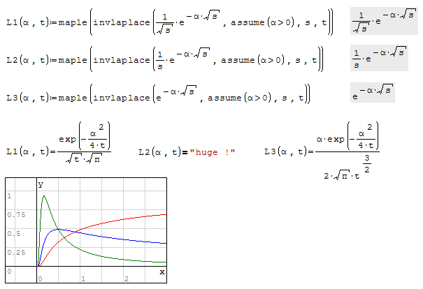

#3 Posted: 4/4/2016 7:28:47 PM
983 likes in 6866 posts.
... because of it's high math level, Maple will inverse
any laplace. Smath wraper may not access all Maple.
