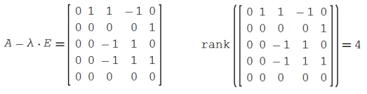

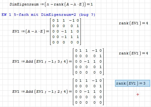

#1 Posted: 4/19/2020 8:24:42 AM
Hallo zusammen,
DimEigenraum: (n-rank(A-λ*E))=1@#
should be 2
some steps of elementary row additions later
is 2
https://de.smath.com/cloud/sheet/vooDFR4FbP
any idea whats wrong?
should be 2
is 2

#3 Posted: 4/19/2020 10:19:42 AM
Upps, sorry
Made a link
https://de.smath.com/cloud/worksheet/3BgYDE7e,
Maxima pure
(%i6) A: matrix([1,1,1,-1,0],[0,1,0,0,1],[0,0,0,1,0],[0,0,-1,2,1],[0,0,0,0,1])$
(%i7) A-1*ident(5)$
(%i5) rank(A-1*ident(5));
(%o5) 3
but
Maxima(rank(A-1*identity(5)))=4
or

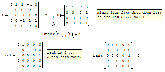

#6 Posted: 4/19/2020 2:09:48 PM
Wroterank(M) ... matrix rank is Smath built-in.
Matrix PseudoInverse.sm (111.21 KiB) downloaded 1211 time(s).
and in how far do your example explain the incorrect calculation
WroteThe referenced sheet seems to use Maxima(). This doesn't work, as third party plug-ins aren't available in the cloud version.
It is better to attach such files here.
the Maxima part calculate the single eigenvalue which is set manually in cloud version
![SMath Studio 0.99.6884 - [JordanMatrix5x5-5fachEW-HV.1.2.Stufe.sm_]_2020-04-19_19-07-08.jpg](/en-US/files/Download/SRDYrq/SMath-Studio-0.99.6884---[JordanMatrix5x5-5fachEW-HV.1.2.Stufe.sm_]_2020-04-19_19-07-08.jpg)
JordanMatrix5x5-5fachEW-HV.1.2.Stufe .sm (47.19 KiB) downloaded 1175 time(s).
#7 Posted: 4/19/2020 11:51:44 PM
#8 Posted: 4/20/2020 11:51:33 AM
Wroteand in how far do your example explain the incorrect calculation
Just advanced maths above the classroom.
Your example replies bug from incorrectly threaded input.
As given, your [5*5] matrix has no mathematical meaning.
Page1 rank.sm (11.74 KiB) downloaded 1344 time(s).
