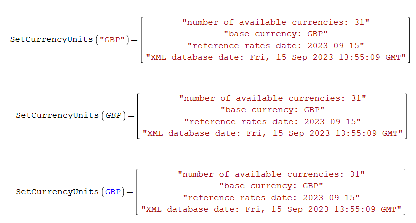

#6 Posted: 9/15/2023 5:48:11 PM
1,430 likes in 2,891 posts.
Hello, The SetCurrencyUnits() function is not posting the current rates.
Fixed both SetCurrencyUnits(1) and SetCurrencyUnits(2), plugin released for latest version of SMath Studio stable.
