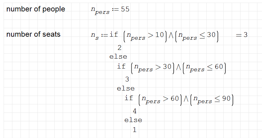

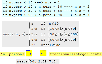

Hi I try to explain better what I want to calculate.
I would like to set up a for loop that allows me to do the same calculations as the if loop in the figure.
for example
if n.pers < 10 ---> n.s = 1
if n.pers > 10 & n.pers < 30 ---> n.s = 2
if n.pers > 30 & n.pers < 60 ---> n.s = 3
if n.pers > 60 & n.pers < 90 ---> n.s = 4
and so on
I don't know how if it's possible set up this cycle, anyway thanks.
#5 Posted: 10/12/2021 1:57:13 PM
599 likes in 1,381 posts.
for example
and so on
You don't need an iteration.
Ceil() and cases() shall work for you.
Davide Carpi 10/12/2021 4:15:00 PM
#6 Posted: 10/12/2021 2:29:11 PM
talpacolore
talpacolore
0 likes in 4 posts.
Hi
I'm probably doing something wrong because, for exemple, with 40 or 70 it doesn't work.
#7 Posted: 10/12/2021 2:38:28 PM
Hi
Probably, please use the file below.
seats.sm (2.79 KiB) downloaded 1209 time(s).
#8 Posted: 10/12/2021 2:50:02 PM
127 likes in 342 posts.
The suggestion of Overlord is correct. You can also define a function and make different corresponding values ​​calculate (using the Vectorize function)
number_seat.sm (6.94 KiB) downloaded 1275 time(s).
#9 Posted: 10/12/2021 3:11:23 PM
talpacolore
talpacolore
0 likes in 4 posts.
Thank to all. you are great!
I used an old version. Now work correctly in my pc, too.

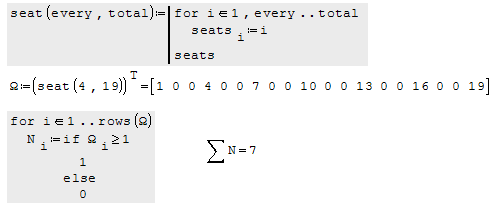

#10 Posted: 10/12/2021 3:41:15 PM
Page8 Social.sm (16.79 KiB) downloaded 1474 time(s).
#11 Posted: 10/12/2021 5:42:31 PM
Not related with OP's question.
