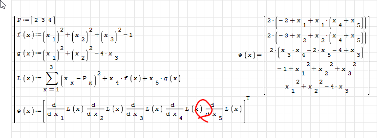

SMath Forum SMath Studio Bugs & Problems The sum of derivatives has problems. The last line is missing 1 Pages (2 items) The sum of derivatives has problems. The last line is missing - The sum of derivatives has problems. The last line is missing - Messages Go to last post #1 Posted: 9/22/2020 3:25:59 AM Fridel Selitsky 520 likes in 451 posts. Group: User The sum of derivatives has problems. The last line is missing.Bag.sm (17.58 KiB) downloaded 1303 time(s). #2 Posted: 9/22/2020 4:11:21 AM Martin Kraska 1,357 likes in 2,271 posts. Group: Moderator just a typo (+ instead of argument separator after 4th entry) Technische Mechanik mit SMath Studio: https://link.springer.com/book/10.1007/978-3-658-50592-9 2 users liked this postFridel Selitsky 9/22/2020 4:18:00 AM, Davide Carpi 9/22/2020 2:30:00 PM 1 Pages (2 items) New Posts No New Posts
