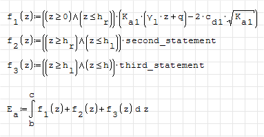

Hello, I have very annoying problem, i don't know how define this integral from mathcad in smath:
Integral Problem
I read some tutorials from wiki, and i still don't know how write it in smath
Could anybody help?
Thanks
Piotr

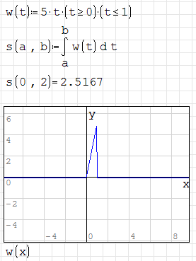

Try this
regards,
Davide

see also the piecewise integral topic on mkraska's handbook
