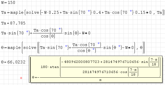

I found this behavior working with Maple plugin:
arctan() function not defined
I think that it would be easily fixed by uni
Thanks in advance!
Oscar

Oscar, could you attach the file and the log (mvr5.txt)? As for me your example works fine.
Here the files.
Thanks in advance!
Oscar

Fixed and updated. Try now.
