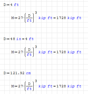

#3 Posted: 3/28/2016 6:41:54 PM
#4 Posted: 3/29/2016 12:51:49 PM
What Davide said or understand where the constant comes from. You'd be surprised how many people "forget" how the constant is derived. SMath carries the units and modifies as needed internally... Derive Constant.sm (3.76 KiB) downloaded 1340 time(s).
