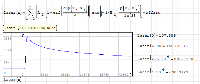

No issues I think,
the guilty is 1+erf()*exp() that should be (1+erf())*exp();
Let me know if there are other issues (erf is part of StatisticalTools)
Scrap Laser.sm (35.36 KiB) downloaded 851 time(s).

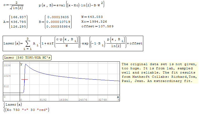

The "laser fit". Quite involved behind the scene.
Davide Carpi 4/18/2016 8:04:00 PM
