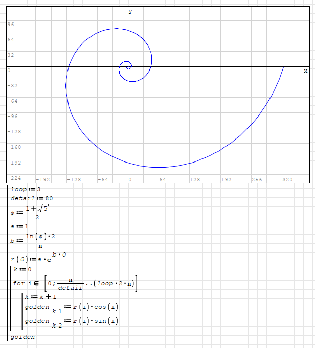

Here is plot of a logarithmic spiral.
It's growth factor is golden ratio.
Detail and loop count can be adjusted.
PS: Jean, please don't post anything under this topic.
goldenspiral.sm (5.28 KiB) downloaded 1514 time(s).

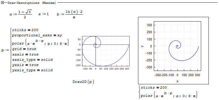

For Maximalists, here a version with the Draw2D() function and an image region (left) and with a Draw2D-region.
Blatt23.sm (151.66 KiB) downloaded 1536 time(s).
