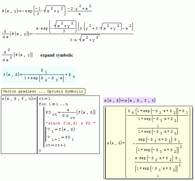

#12 Posted: 5/26/2016 11:46:52 PM
1,139 likes in 1,805 posts.
The way you write "diff(f,x)=0" ... I read 1rst derivative of 'f' wrt 'x'
then equate to 0 for roots. Simple: assign diff(f,x) to a new function,
Hi Jean. Yes, you're rigth. What I must to wrote was diff(f,x) identically equals zero, i.e. f'(x)=0 for all x in Domain(f). This is the good definition for independence criteria, and, as you say, diff(f,x)=0 is for search critical points.
