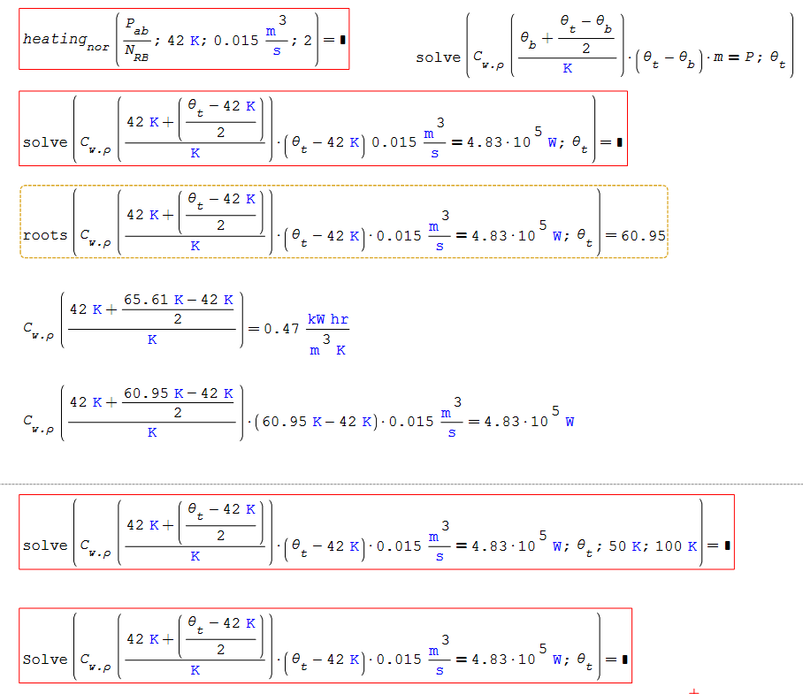

However, my struggle doesn't seem to be over. Equations-solving functions like solve, roots, and Solve do not return any answer except for the 'roots' function when solved without units.
Can you please provide your expert opinion on this situation?
#4 Posted: 1/5/2025 7:39:49 PM
1,361 likes in 2,275 posts.
Please attach the .sm file.
