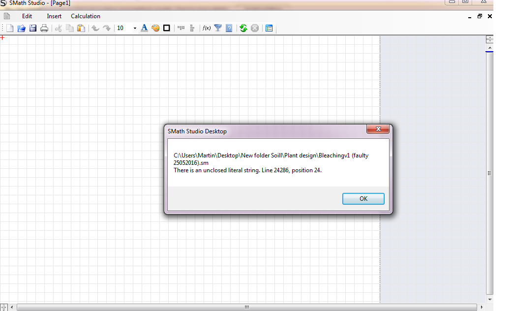

Hi all, have anyone come accross the below problem ? Where the file suddenly says there is an "unclosed literal string" and then all your calculations are lost. Is there a way to recover the original info on the smath file ? This happens mostly when updating the smath..

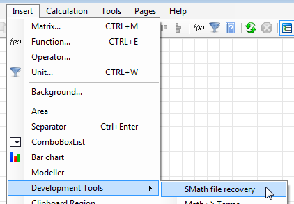

The file was saved using which version of SMath Studio? There were similar issues in version previous to 0.98, related to images.
To try to recover the file, you might download from the Extensions Manger the "Development Tools" plugin and run the "Smath File recovery" utility (Insert > Development tools > SMath file recovery).
