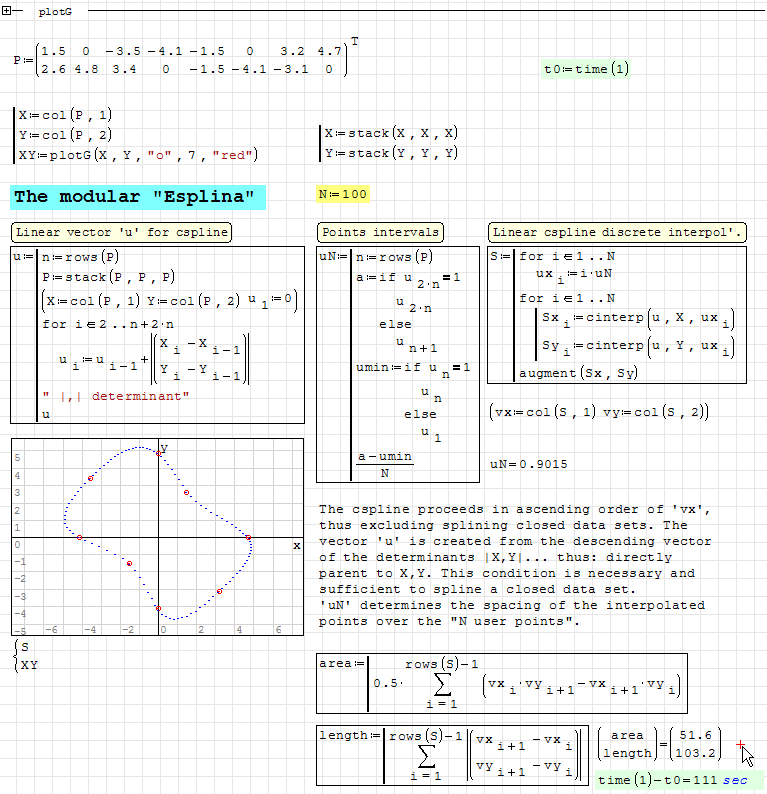

#1 Posted: 9/12/2016 2:36:46 PM
This one works well for the given data set. Mesh finer at will and if needed,
bilinear ... not much use for bilinear, whereas "spline" is just something.
Spline Esplina [AI2000].sm (23.66 KiB) downloaded 1213 time(s).
#2 Posted: 9/12/2016 7:08:01 PM
... a faster version: one twin col extractor removed.
By same token, I wonder why the col extractor col(,,) is so slow ?
Spline Esplina [AI2000].sm (23.75 KiB) downloaded 1238 time(s).

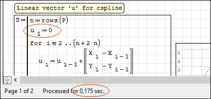

#8 Posted: 9/13/2016 12:08:37 PM
WroteYou forgot to specify first element of u vector.
By doing so you can speed up calculation even more:
Thanks Andrey, damned me !
While you are there, can you speed up "DeBoor" ?
Spline De Boor [Esplina].sm (47.76 KiB) downloaded 1218 time(s).
#9 Posted: 9/13/2016 12:47:49 PM
Done
Spline De Boor [Esplina]_mod.sm (47.37 KiB) downloaded 1295 time(s).
Timings:
Regards.
Timings:
- 6.1 seconds by 0.97.5890
- 2.3 seconds by 0.98.6096
Regards.
