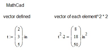

I would simply like to define a vector, then apply a operation to each element and have the results in a second vector. This seems to be simple in MathCad but I can't seem to get it in SMath Studio.
In MathCad

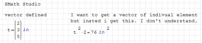

In SMath Studio I get this. I'm not shre just what this result is.

The result is the sum of the squares of the elements, multiplied by two.
As far as I know SMath does not support vectorization (yet) so, in order to obtain what you need, you should use a for loop.

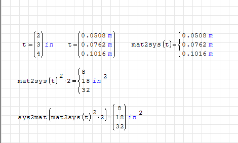

#3 Posted: 10/16/2013 12:01:48 PM
If you are using vectors, then you can try mat2sys() and sys2mat()
#4 Posted: 10/16/2013 1:35:36 PM
Jay May
Jay May
3 likes in 10 posts.
Thank you mb10, I got the For..Loop to work it out. I was wondering if the vector options were available or not.
To omorr, the mat2sys() and sys2ma() looks like a clean method to acheive these functionality but how do I add the mat2sys() and sys2mat() functions?
Thank you.
#5 Posted: 10/16/2013 4:46:28 PM
1,361 likes in 2,275 posts.
mat2sys and sys2mat are part of the CustomFunctions plugin by Davide Carpi. You can install it using the extension manager (Tools> Plugins) or use the unofficial distribution with pre-installed plugins (link in the signature).
You also might consider using the Maxima Plugin (which requires Maxima to be installed on your system)
Radovan Omorjan 10/17/2013 1:06:00 AM
