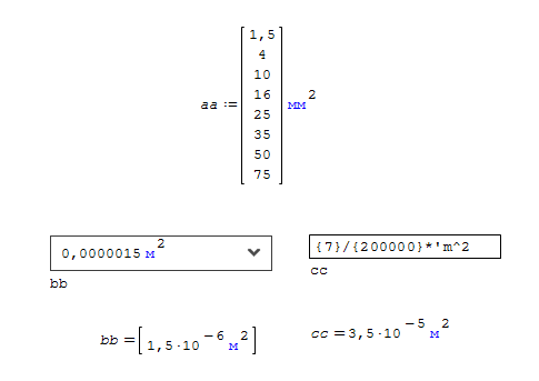

Здравствуйте.
Используем Вашу программу в небольших расчетах. Очень нравится визуализация расчетов, когда требуют предоставить формулы расчетов.
В работе используем расширение список или комббокслист, в расчетах очень часто встречается выбор. С недавнего времени начали вводить в расчеты единицы измерения, и это привело к проблемам со списками. Можно ли сделать так что бы выбираемые значения имели те же единицы что и указанные в матрице? Прикладываю проблему.
Возможно мы что то не знаем и все уже решено. Заранее спасибо!!!
Hello.
We use your program in small calculations. I really like the visualization of calculations when they require the provision of calculation formulas.
In the work we use the list extension or combo boxlist, in the calculations very often there is a choice. Recently, units of measure have been introduced into the calculations, and this has led to problems with lists. Is it possible to make the selected values have the same units as those indicated in the matrix? Applying a problem.
Perhaps we don’t know something and everything has already been decided. Thank you in advance!!!

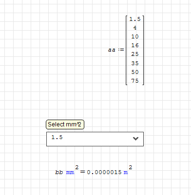

#2 Posted: 10/14/2019 3:41:58 PM
Edit: See Sergio's post below.
If you really want to choose those values, you can create the list without units and apply the units in calculation. Note that the result of calculation will still be in SI, and you'd have to change those manually as well if you wanted to show different units.

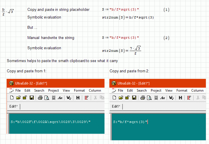

Hi. I guess that this is the origin of the problem:
StringProblem.sm (21.45 KiB) downloaded 1222 time(s).
#10 Posted: 11/13/2019 5:44:33 AM
WroteHi. I guess that this is the origin of the problem:
I tried to write hands and paste from a notebook in the coding of UTF-8 and ANSI. Repeat what you did under (2) did not work.
My version of the program is 0.99 (6884), maybe there have been changes?
I'll try to update.
Update did not help.
