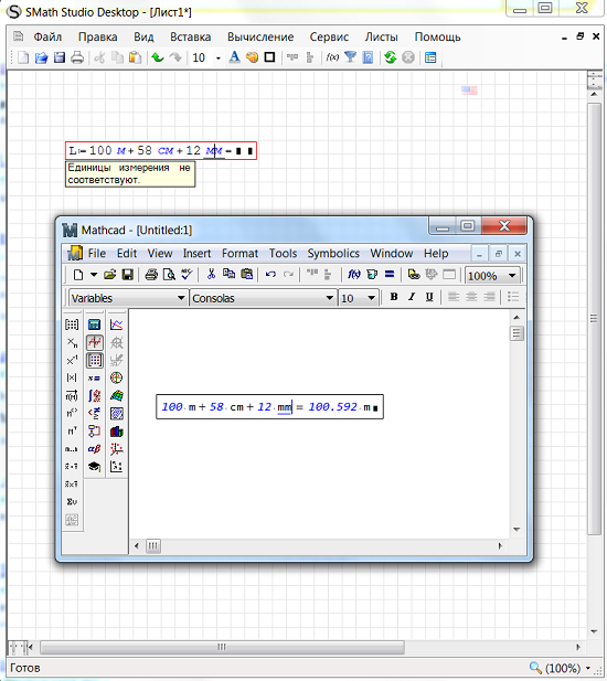

#1 Posted: 7/11/2014 3:18:16 AM
1,555 likes in 1,866 posts.
Why this not working?
#2 Posted: 7/11/2014 3:36:24 AM
127 likes in 342 posts.
because of caps?
[albumimg]354[/albumimg]
#3 Posted: 7/11/2014 3:42:26 AM
I use russian units. They do not work. I don't know is this a bug or not. English units are working fine.

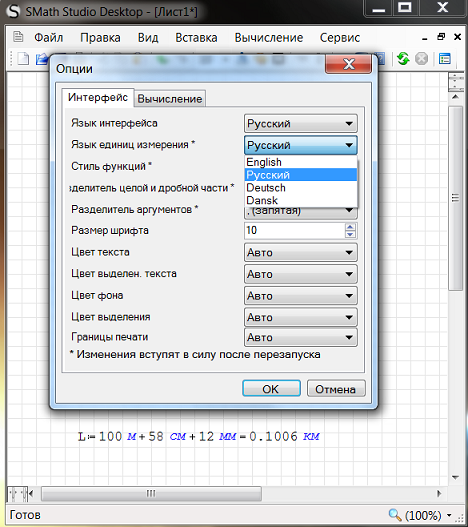

#5 Posted: 7/11/2014 4:40:15 AM
Thank you Radovan, now it works fine (default was English.).
#6 Posted: 7/11/2014 4:45:24 AM
Thank you Radovan, now it works fine.
Uni, I do not understand . I can not use my languages in this build (neither Serbian Latin, nor Cyrillic) and if you and other people can do this, this must be my computer fault. I will try on some other computers to see if the problem persists.
