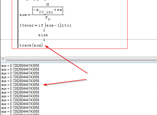

#2 Posted: 5/24/2014 2:23:18 AM
It seems (not sure) that your code does not change the exit loop condition and you are in infinite loop - see the picture please.

#4 Posted: 5/24/2014 4:55:39 PM
600 likes in 1,381 posts.
at the end of iteration, nothing changes. iteration means values you start with have to change for the next iteration. same values are being used in every iteration. same aux is being calculated every time. the loop can not end this way. at the end, i am saying the same thing that omorr have said i hope i could help.
you were rigth, i forgot to redefine xIC_ini in the last else... thanks
