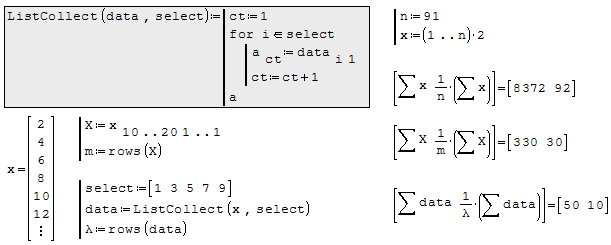

Hello! I need to insert 91 numbers and use the sum function in a formula to sum them.
This is the formula I need to make:
https://i.imgur.com/89KDAWa.png
Could you please tell me how can I accomplish this? How do I make an "i" index and how do I define "n"?
I am a complete novice in using Smath, this is for a university coursework.
Thank you very much!
#2 Posted: 2/18/2020 3:21:33 PM
NDTM Amarasekera
NDTM Amarasekera
130 likes in 352 posts.
Hello.
This may be helpful.
Summation EX.sm (214.79 KiB) downloaded 1158 time(s).
