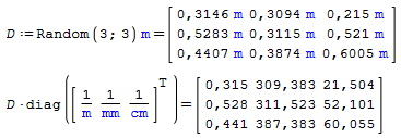

Assuming you have a table with columnwise uniform units, then the following approach provides full control:
exportdata.sm (4.81 KiB) downloaded 1197 time(s).
