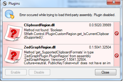

Why they do not load?
Thank you,
Basile
#2 Posted: 5/22/2014 9:49:34 AM
1,430 likes in 2,889 posts.
These plugins are outdated since SMath Studio 0.96.5146; as mentioned here these plugins shouldn't be visible, anyway about ClipboardRegion the development will continue when the clipboard issues of SMath Studio will be fixed.
