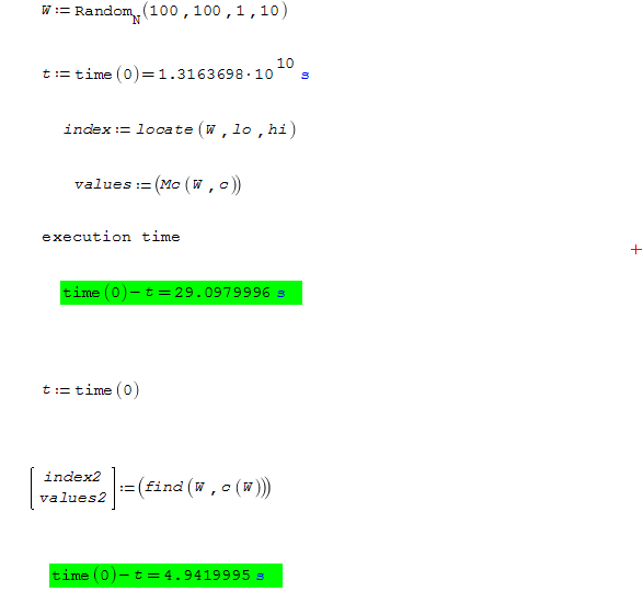

Great stuff. I think I've optimized the algorithm for larger matrices by modifying my find algorithm from interX.
For a 100x100 matrix the execution time is improved by nearly 6x.
Utilities Matrix Truth Table [Locate row_col]_alyles.sm (23.14 KiB) downloaded 1015 time(s).
