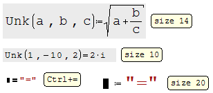

#5 Posted: 11/8/2021 5:09:40 PM

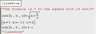

#6 Posted: 11/8/2021 5:19:23 PM
... Formatted Label is lot more advanced/presentable.
Image Formated LABEL [Oxyhemoglobin].sm (17.32 KiB) downloaded 1371 time(s).

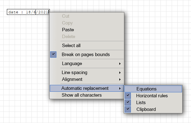

1 - How to enter the equal sign in as text?
2 - Anyway to make the icons larger?
1 - Deactivate equation replacement for text region.
2 - No way at the moment.

The "Deactivate Text Region" option in the Edit Menu only appears under certain circumstances it seems.
I must start typing the first word and then click Edit and Deactivate Text Region appears and I can turn it off...
but if I type a word and hit space... the option is not there.
Am I missing something on finding the Deactivate Text Region option?
The "Automatic Replacement" choice under the Edit Menu
is also hard to find as it only appears after I type a word followed by a space.
So, same question...
Am I missing something on finding the "Automatic Replacement" option?
BTW, once I found the "Automatic Replacement" option and turned it off for Equations
It seemed I could enter just about anything with out sMath wanting to calculate...

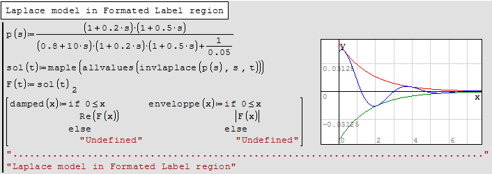

#11 Posted: 11/8/2021 10:04:13 PM
Formatted Label is exceptional for publishing.
Observe that the graph appears once all line arguments are executed.
That compacts the document(s) in more delicious visibility.

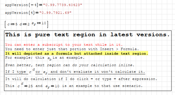

#12 Posted: 11/8/2021 10:26:09 PM
599 likes in 1,381 posts.
Where I can color lines, bold text, find special symbols, etc.
You can do most of things you need with only Text Region.
You can change font, size, bold, italic, color, background color, etc.
You mostly won't need writer region plugin.
We couldn't change internal Text Regions fonts, size, etc back then.
Writer Region plugin was an attempt to include that needs.
Now I use it only for very niche editings.
Jean insists to use very old version of Smath (build 6179).
That old version doesn't have a lot of latest release capabilities.
And it has some calculation errors too. (ref: Andrey, author of SMath)
Conditional Format Label plugin has totally different purposes.
Please download the Reference Book from Tools>Plugins>Interactive books.
And read the CFL plugin section.
textregion.sm (6.03 KiB) downloaded 1550 time(s).
