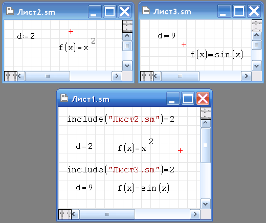

For me it's enough interesting if we can include already build functions form various individual files, for avoiding copy/paste or snipets.
My simply question is if there are in such cases some invisible "collisions" risks, by the use of many "included" functions in a file.
It is necessary to avoid recursion. I still can't catch this type of error in all cases. The only thing to keep in mind - it is the replacement of definitions. But I think this is normal behavior. Or you can suggest the rules how to resolve such kind of collision.
include has a lot of potential, being able to run several worksheets at once from a single worksheet (as stated by you, a sort of improved snippet); the possible collisions (if you don't know the limits):
1) regions with an output to the canvas are not managed -> you may expect values are processed by the regions in the included worksheets, this doesn't happens;
2) there's not a check on the dependancies -> running the worksheets on another system you may miss the required plugins or (in the worst case) a different function with the same name of another (from another plugin not available in the source system) may be incidentally used with unpredictable results.
Вячеслав Мезенцев 3/2/2016 4:02:00 PM, ioan92 3/2/2016 4:17:00 PM

Yes, Davide is right, I forgot about the dependencies. Other worksheets are calculated in the current document environment. This is an important point.

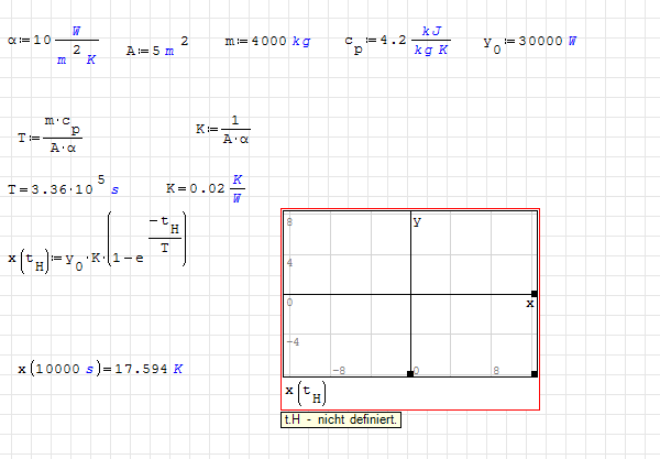

Hi all
2D Plot does not work with units
I tried to plot a function according the instruction of Sebastian Schluricke shown at www.youtube.com/watch?v=AtICkHXHFpk
His example I could easily do. But as soon if I go over to my calculations where I work with units I cannot plot them. I receive only the message variable not defined.
What is wrong here?
Kind regards
Gaselhul
