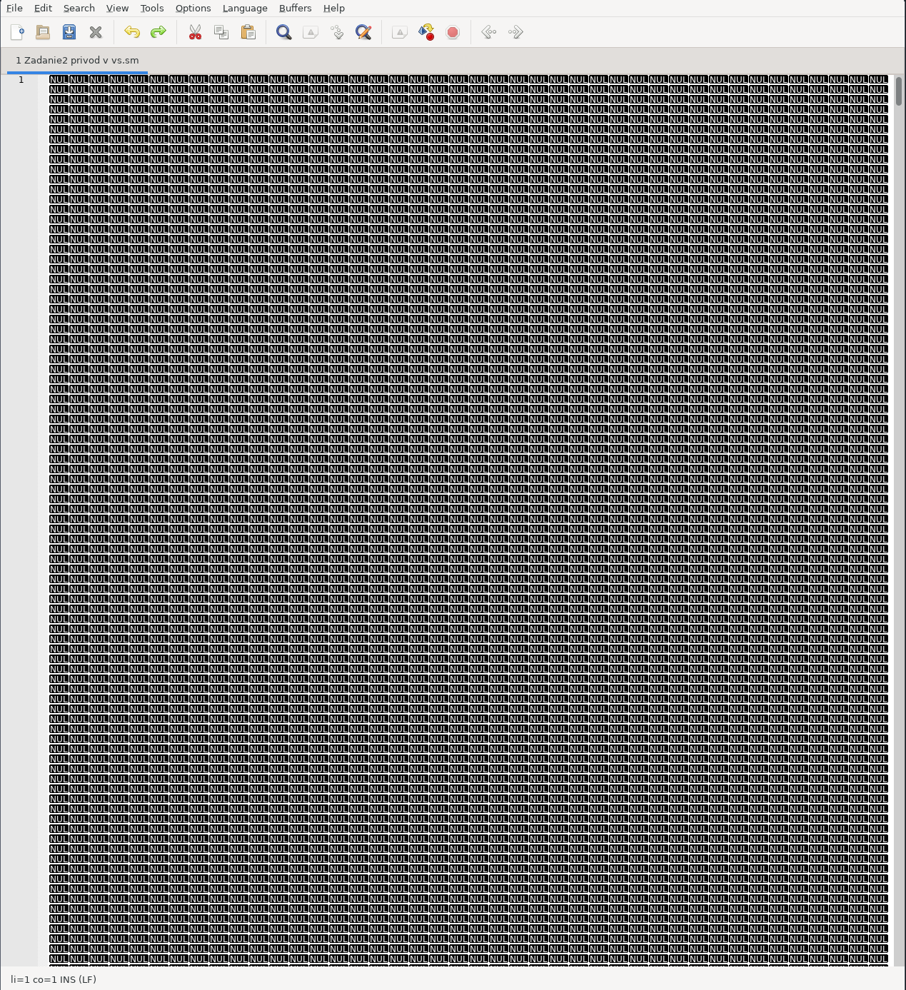

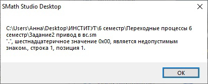

Ребят, помогите программу я закрыла, сохранила. Потом открыть не смогла. Выдаёт такую ошибку. Эксперты помогите! Тут моя курсовая((((
Guys, help the program, I closed it, saved it. Then she could not open it. Throws this error. Experts help! Here is my term paper ((((
",", hex value 0х00, is an invalid character., line 1, position 1.
Zadanie2 privod v vs.sm (218.22 KiB) downloaded 1353 time(s).
#2 Posted: 6/15/2021 4:15:57 PM
599 likes in 1,381 posts.
The file you provided is full of NULL values.
Which means we can do nothing with the file.
I hope you copied and backup the file somewhere.
If not so, I am sorry. Check the recovery softwares.
