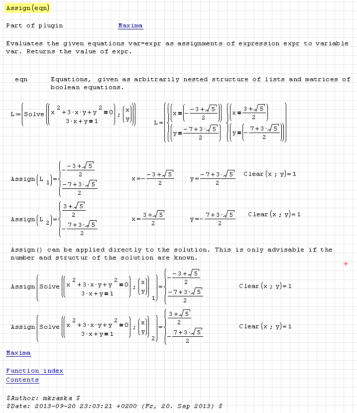

The function Assign() from the Maxima plugin converts a boolean equation into an assignment and displays the result. This is normally used for postprocessing of Solve() and ODE.2() results.

Does the Maxima plugin work with a portable installation of Maxima? (I have wxMaxima from WinPenPack) Or else, Can you manually set the path to find Maxima?
#8 Posted: 11/7/2013 9:57:28 AM
1,440 likes in 2,927 posts.
Yes is possible, look the image attached in the first post of the Maxima Plugin thread
