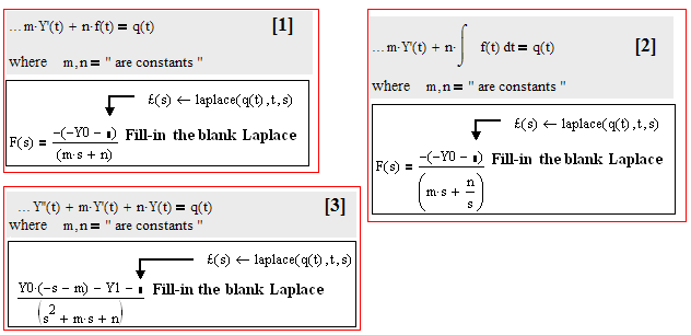

Number of ODE's have symbolic solution.
If your DE has either of these tree forms,
Smath will spits scalar solutions wrt parameters/IC ...
One of my old baby in Mathsoft Collaboratory.
Cheers ... Jean.

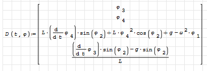

Hi. This is a workaround for that bug: https://en.smath.com/forum/yaf_postsm75052_Problem-with-animated-gif-from-plot-region.aspx#post75052
However, notice that since the values of phi are numbers and not expressions, you cannot compute the derivatives of its components the way you do in D. You can check this by substituting zero for its values, and you get the same numerical solutions.
For diff(el(φ,3),t) you can use el(φ,4), and for diff(el(φ,4),t) you should use some kind of numerical estimate.

Can you update my invented vector 'phi' in red
So that the system makes sense for all visitors.
Cheers ... Jean.

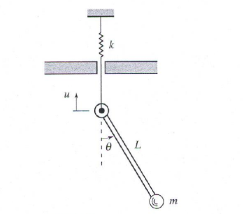

This example is for a pendulum that it's upper end is attached to a spring, The displacement of this upper end is Phi(1) "u" and the angular displacement of the pendulum is Phi(2) "theta". Phi(3) "u_dot" and Phi(4) "theta_dot" are the first derivatives of the upper end vertical motion and the angular displacement of the pendulum respectively.

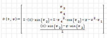

I did a trick and removed the d/dt terms.. but now I got a new problem. The Adams function telling me "Cannot calculate"
