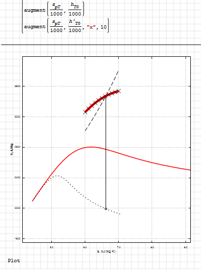

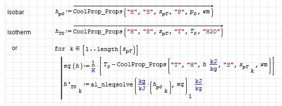

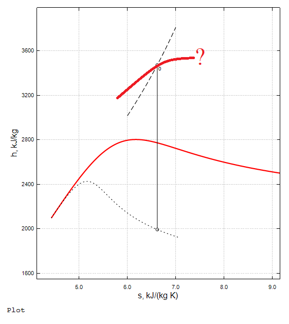

SMath Forum SMath Studio Questions Isotherm 1 Pages (5 items) Isotherm - How to draw it in h-s diagram - Messages Go to last post #1 Posted: 5/20/2024 6:28:22 PM Valery Ochkov 67 likes in 713 posts. Group: User File not found.File not found. #2 Posted: 5/21/2024 12:44:16 AM Alvaro 1,139 likes in 1,805 posts. Group: User Hi. Comparing the result with the other water compound implementation.h-s-diagram-Steam.sm (28.14 KiB) downloaded 1511 time(s).Best regards.Alvaro. 1 users liked this postValery Ochkov 5/21/2024 1:34:00 AM #3 Posted: 5/21/2024 1:38:28 AM Valery Ochkov 67 likes in 713 posts. Group: User My solution. Now I'm thinking about isochore and second isotherm.h-s-diagram-Steam.sm (31.02 KiB) downloaded 1581 time(s). #4 Posted: 5/21/2024 11:03:47 AM Valery Ochkov 67 likes in 713 posts. Group: User With Mathcad Prime and WaterSteamPro #5 Posted: 5/22/2024 5:06:11 PM Valery Ochkov 67 likes in 713 posts. Group: User New versionh-s-diagram-Steam.sm (41.67 KiB) downloaded 1559 time(s). 1 Pages (5 items) New Posts No New Posts
