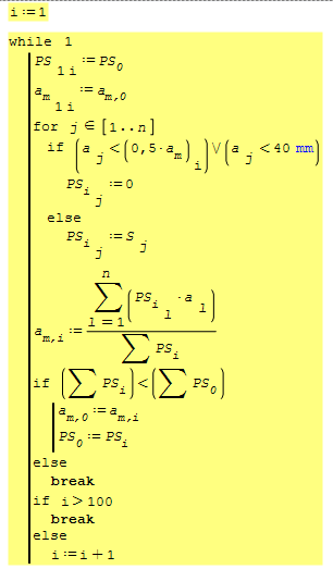

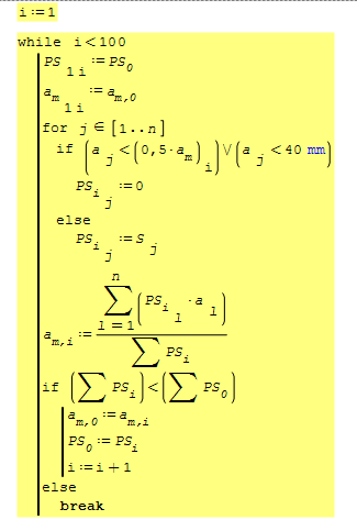

#2 Posted: 3/25/2021 10:15:38 AM
while loop repeats itself as long as the condition (1st argument) it's true. So you need that it's true before the loop starts to run it at least once AND a modifier inside the loop to change it when some criterion is met.
In your example, you migth implement it like this:
![2021-03-25 14_02_55-SMath Studio - [while loop.sm_].png](/en-US/files/Download/54Qqsh/2021-03-25-14_02_55-SMath-Studio---[while-loop.sm_].png)
you can even move the i<100 check inside an infinite loop loop
![2021-03-25 14_11_50-SMath Studio - [while loop.sm_].png](/en-US/files/Download/bHkzBx/2021-03-25-14_11_50-SMath-Studio---[while-loop.sm_].png)
#3 Posted: 3/25/2021 10:47:51 AM
Davide,
Thank you for the suggestion. The condition for continuing the loop should be (sum(PS.i))<(sum(PS.0)).
For this kind of iteration, does one make more sense over the other?
Best regards,
Best regards,
#4 Posted: 3/25/2021 5:33:20 PM
When working with while you have to focus mainly on how to stop the loop. If there is always a convergence, then you are fine. But if you get stuck in an infinite loop the program might crash. So be careful if you plan to not cap the number of iterations.
