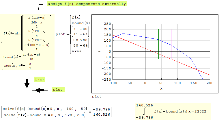

... Dichotomy added for solving in the complex region.
2D Plot Discontinuous [min(,)].sm (27.31 KiB) downloaded 884 time(s).

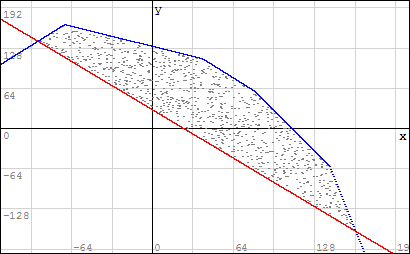

#6 Posted: 9/28/2019 6:35:33 PM
filling the loft added.
2D Plot Discontinuous [min(,)].sm (44.7 KiB) downloaded 905 time(s).

#8 Posted: 10/1/2019 8:35:03 AM
but how do you set your graph axis
1. Dispose the plot from plotting using Smath @ QuickPlot
zoom, shift left/right, up/down ...
2. Plot on the X_Y, set the X ± limits, Y ± limits.
3. plot ... 4. specify the traces from "list"
As simple as explained, no sweat ! ... Last plot.
2D Plot Discontinuous [min(,)].sm (44.49 KiB) downloaded 918 time(s).
