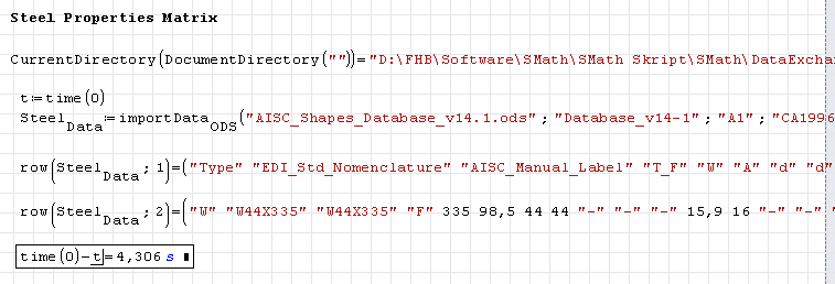

#4 Posted: 11/12/2013 12:59:10 PM
Do you think this excel file is too big? I was not able to reach the end of the calculation time.
See attached
Steel Properties.zip (1.18 MiB) downloaded 398 time(s).
See attached
