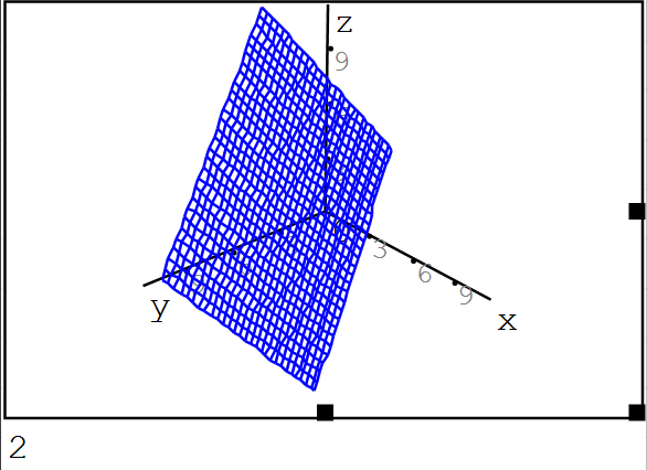

Attached is a simple file showing my problem, with a screen shot.

yes it is a known bug, you have to click the refresh button on the plot palette.

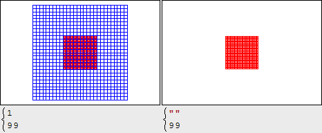

What's the problem ? in native mesh.
If you mean zoom is crappy, for sure it is not an image Fourier zoom.
Just an ordinary multiple/fractional zoom.
3D Plot.sm (61.83 KiB) downloaded 1208 time(s).
Rotate Breather [4 Orientations].sm (1001.04 KiB) downloaded 1091 time(s).
