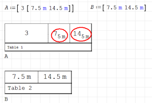

#1 Posted: 8/27/2023 5:58:19 AM
Hello !
I have this display problem when trying to pass
a matrix to a Table.
Table_Region_Problem.sm (11.47 KiB) downloaded 1564 time(s).

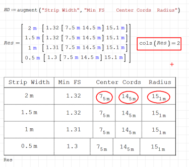

#3 Posted: 8/27/2023 3:07:33 PM
Hello !
My post #1 is a simple example to show the Table Region problem.
The actual problem is related to a Slope Stability Analysis example,
where the result consist of the following.
1. Strip width
2. Relevant Min Factor of Safety (Min_FS)
3. Center cordinates (x,y) of slip circle relevant to Min_FS
4. Corresponding Radius of slip circle.
1. Strip width

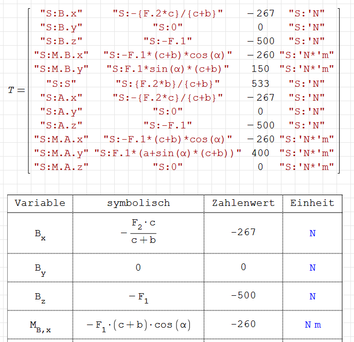

#4 Posted: 8/28/2023 4:31:21 AM
In the attached sheet I tried to automatically compile a results summary. Note that there is a single entry point for unit specification in the algorithm (no chance for mismatch between displayed unit and unit used to calculate the numerical values.
1-3.sm (137.75 KiB) downloaded 1551 time(s).

#5 Posted: 8/28/2023 7:53:00 AM
WroteMy post #1 is a simple example to show the Table Region problem.
At post #3 construct the matrix as independent cols, thus compatible Table.
Next, nest the two pertinent cols to explicit your Engineering c/w header.
