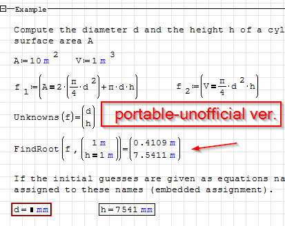

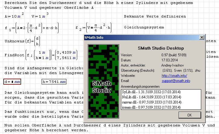

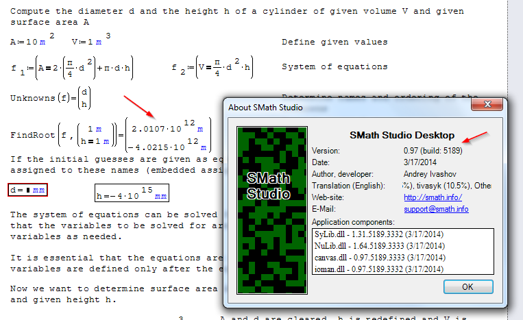

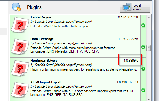

WroteNS version is 1.0.9999.5 for both of you (Martin and Radovan)?
Hello Davide,
I also confirm the plugin version - see the picture please.
BTW, this is the same on my both computers home-Win7 32bit, office-Win7 64bit
Added in BTS: SS-139

WroteI hate to be such a newbie and ask stupid questions but how do I go about installing the "Nonlinear Solvers" plugin? I tried this and got a request for a password. That seemed very strange to me. I am using build 4909 on Linux.
Also, I discovered that I can solve this system of equations using the "roots" function but I had to do it without units. Is this a reason to use the FindRoots method or am I just using the roots method wrong? BTW, I stumbled across the other real solution of d=2.292 and h=0.242.
I am SO much more proficient with MathCad (version 6.0+) and this frustrates me right now. I hope to be comfortable with SMath soon but it will take a bit. Once I am I plan to teach a class at my work on how to solve problems using SMath. Thanks for your help.
There are no stupid questions... In the Extensions Manager (EM) some plugins are protected by passwords because are new (potentially unstable) or under development. You may find the most of them in the Extensions section of the forum. About Nonlinear Solvers here there is the official thread (and the first post contains the password).
roots/solve are really powerful but units are not supported; this is just one of the things behind the development of the plugin (BTW more or less all the algorithms of this plugin are available also as worksheets).
