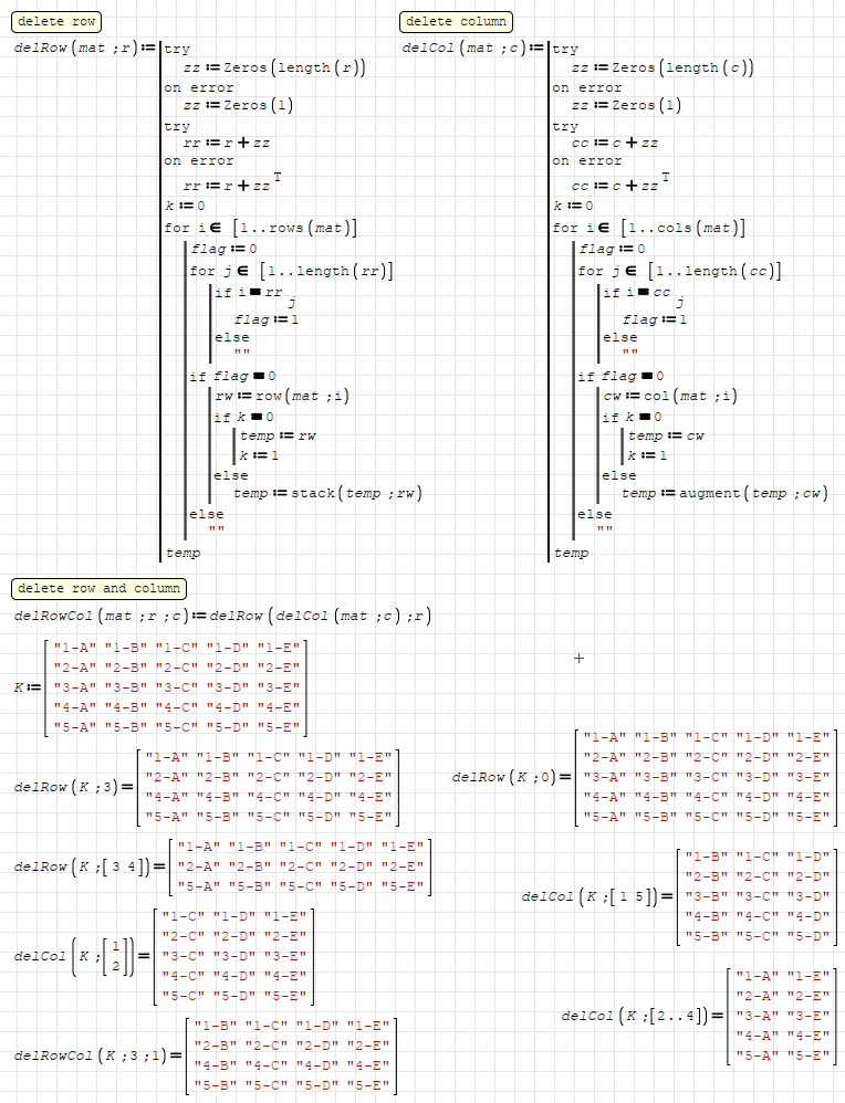

Some functions for row and column deletion.
For row and column functions accepts horizontal and vertical vectors, range(2) and range(3), numbers.
No need to convert anything during input, and exceeding and subceeding values not be removed.
delete_rowcol.sm (21.39 KiB) downloaded 1425 time(s). (old method)
delete_rowcol.sm (15.58 KiB) downloaded 1423 time(s). (new and faster method)

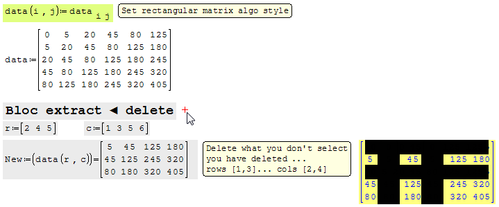

Otherwise useful ... you delete what you don't select.

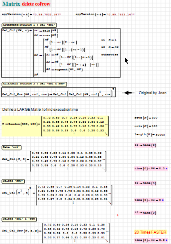

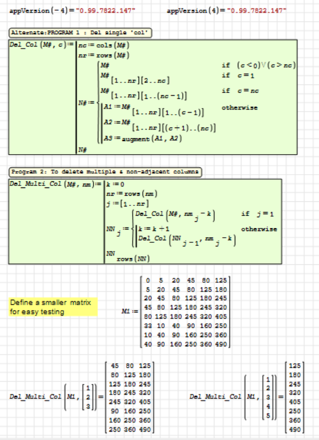

Alternate program. Very fast on large matrix.
Jean's program very helpful. Thank you Jean
New_Matrix_Delete [col_row].sm (24.06 KiB) downloaded 1301 time(s).

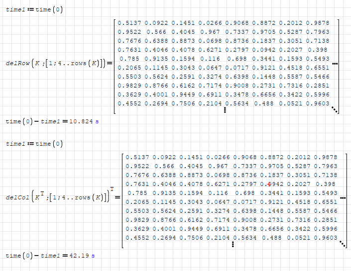

I tried your solution and found out it is faster with single row or single column removal. Good job.
And also found out transpose method is way much slower if I use ranges or matrices for input.
That method is not fast enough and not a good method when you use vectors of columns or rows for removal.
So I have combined your solution with mine, a fast and feature-full method is born.
New file is added in first post.

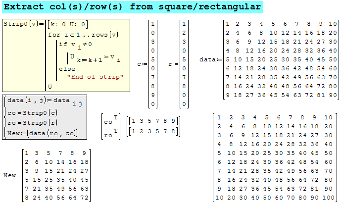

From square/rectangular matrix algo style do all at will.
1. delete cols & rows in any shuffled ways.
2. conserve selected rows deleted of 'j'.
3. conserve selected cols deleted of 'j'.
Hopefully, no red in your SS version !
Thanks, be good ... Jean.
Utilities Matrix Minor [col_row] ADVANCED OTHERWISE Copy.sm (21.58 KiB) downloaded 1317 time(s).

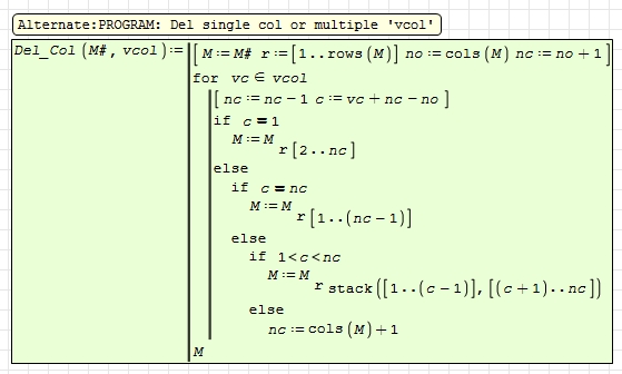

A revised version, to delete multiple non-adjacent columns.
Faster on large matrix than my last example in post #3.
New_Matrix_Delete [col_row]_R2.sm (41.9 KiB) downloaded 1273 time(s).
