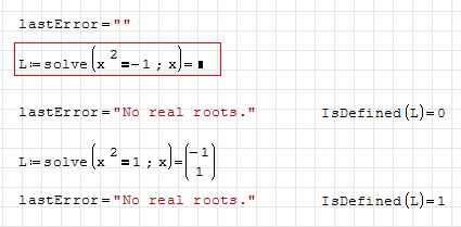

#5 Posted: 10/29/2015 2:13:49 PM
1,361 likes in 2,275 posts.
I think you don't understand what I wish to know. Let me rephrase my question is: is there a way to detect that two functions are NOT CROSSING without error. I was thinking maybe there is a function that detects errors so I could write something like: If_Error(Solve(f1(x);f2(x),x))= 1 if f1 and f2 are not crossing.
You can assign the result of solve to a variable and check if that variable is defined. If not, you can check lastError.
