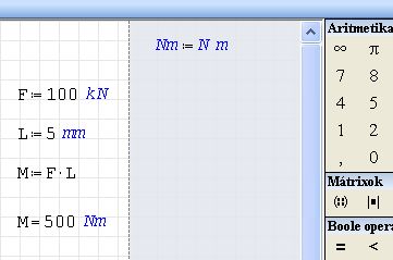

I typed it in the way kadpeter's example shows, but I'm still getting Joules as the resulting unit of measure...
Image:
http://snag.gy/n4ZRf.jpg
Can anyone walk me through the steps for achieving the results in N*m? Isn't a major issue, but it would be nice to know how to do this.
Because you didn't enter the apostroph. In Kadpeter's example you have to type 'Nm:=N*m The apostroph will disappear and Nm become blue
#14 Posted: 10/17/2014 7:30:57 PM
Sólyom Csaba
Sólyom Csaba
0 likes in 2 posts.
@mkraska: Thanks for pointing out that there is a portable version of SMath. Great addition to my toolbox.
@brotjob: That solved my problem, and my custom units are working more-or-less as I would like them.
