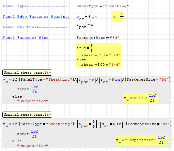

Hi All,
I'm trying to write an if statement that determines capacities based on certain inputs.
I've attached the sheet in question.
I'm not sure if it's something on my end, but for certain fractions/values the if statement will not produce the correct value.
For instance, if my tpan value is set to 3/8 inch, it will work correctly.
But if I set it to 1/4 inch, it will not work correctly.
test.sm (8.15 KiB) downloaded 1342 time(s).

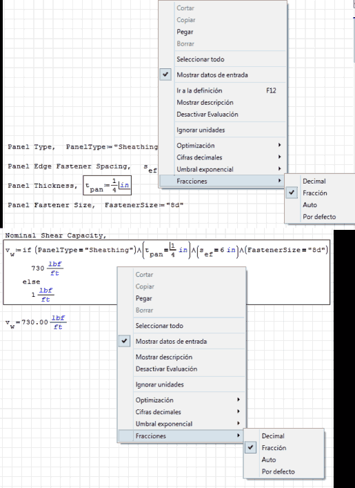

Sometimes using units have issues. In this case, if you right click the "vw" equation, and choose fractions menu and choose fractions, it will work.

I think it is related to SS-2300 (booleans vs imperial units)

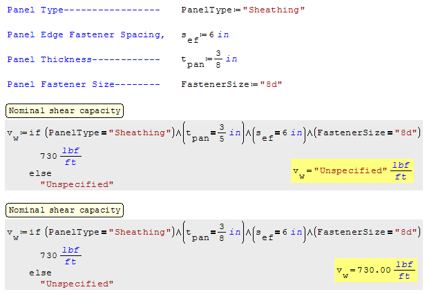

#4 Posted: 7/13/2016 9:21:14 AM
WroteBut if I set it to 1/4 inch, it will not work correctly.
Yes it does work correctly: it does reply the otherwise specified for any non 3/8.
Forum LOGIC.sm (10.25 KiB) downloaded 1297 time(s).

@Davide Carpi, Yes I tested this and noticed there was no issue with Metric units. Sorry, I didn't find the bug when I searched.
@Jean Giraud, I guess I didn't explain it very well. I meant that if I change the input variable tpan = 1/4 in and also change the boolean to determine if tpan = 1/4 in, the evaluation will not return the correct output of 730 lbf/ft. See the bug report Davide linked for a better explanation.

Wrote@Jean Giraud, I guess I didn't explain it very well. I meant that if I change the input variable tpan = 1/4 in and also change the boolean to determine if tpan = 1/4 in, the evaluation will not return the correct output of 730 lbf/ft.
Your original specification is for returning 730 lbf/ft for 3/8. If you change for 1/4,
how and why should it return 730 lbf/ft ? Smaller size has lower shear capacity.
If it wouldn't be so: hair size would also be 730 lbf/ft. Your system is underdesigned
for end purpose, that's my conclusion. Your unspecified 1/4 returns meaningless 1 lbf/ft.
If you don't have same as me: it's a version problem
#8 Posted: 7/13/2016 1:09:30 PM
WroteWrote@Jean Giraud, I guess I didn't explain it very well. I meant that if I change the input variable tpan = 1/4 in and also change the boolean to determine if tpan = 1/4 in, the evaluation will not return the correct output of 730 lbf/ft.
The strength values are irrelevant to the issue at hand which is the bug with input imperial units. I was trying to show the discrepancy for certain thickness input values and used the same shear strength output to explain. The reason why your if statement works is because you have removed the imperial unit issue as already mentioned. See attached screenshot and sheet.
