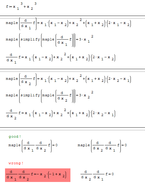

Look at this please
[MATH=eng]f:el(x,1)^3+el(x,2)^3[/MATH]
This is correct:
[MATH=eng]diff(diff(f,el(x,1)),el(x,2))=0[/MATH]
But this is obviously wrong:
v0.95
[MATH=eng]diff(diff(f,el(x,2)),el(x,1))=-el(x,2)*(-1+el(x,2))[/MATH]
It seems that is still present in v.90 as well:
v0.90
[MATH=eng]diff(diff(f,el(x,2)),el(x,1))—-(-1+el(x,2))*el(x,2)[/MATH]
In v0.89.8 you will get the right answer - zeros for both mixed derivatives.

seem related to the symbolic simplification (see the attachments)
regards,
w3b5urf3r
derivatives_debug.sm (36.92 KiB) downloaded 1228 time(s).

Here some (probably) related issues.
best regards,
w3b5urf3r

It's the way SMath handles/prioritizes ASCII characters. I ran into a similar issue with MathCAD. In this case, the second variable of "x" (in the equation) has to be the first variable of the first derivative as shown in w3b5urf3r's screen shot.

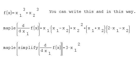

I must be boring with this , but I think there is neither solution nor satisfactory explanation of this "glitch" regarding second derivatives.
Still present in 0.96

Yes, I know. Thank you . I did it on purpose, just to put the stress that maple did it right.
