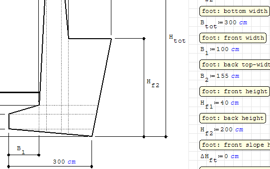

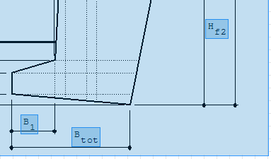

You cannot write dynamically results inside an image, but you can place results (math regions) over your image.
Namely, if you have a region (let say your image), any other region (let say the math regions) with a top-left corner below the one of the image (or at the same vertical position but on the left) will be drawn over the image region.
2016-04-19 16_50_47-SMath Studio Desktop - [ReWallDesigner_2012.00.03a.sm_].png
You can move better the overlapped region using the CTRL key and the mouse selection (hold down the CTRL key, click and hold down the left button of your mouse and drag a selection region; do it again to unselect items; finally you can move the selected items with the keyboard arrows)

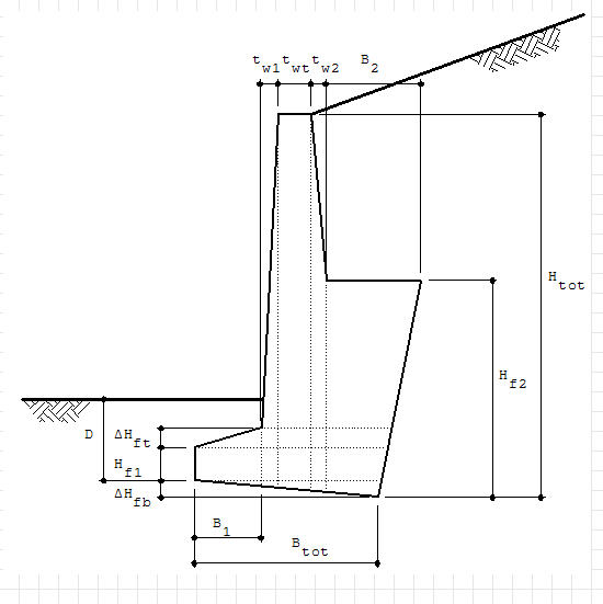

2016-04-19 16_51_19-SMath Studio Desktop - [ReWallDesigner_2012.00.03a.sm_].png
If you don't need to see the LHS (Left Hand Side of the equation), the context menu of the math region contains a "Display input data" item to uncheck (right click over the math region)
