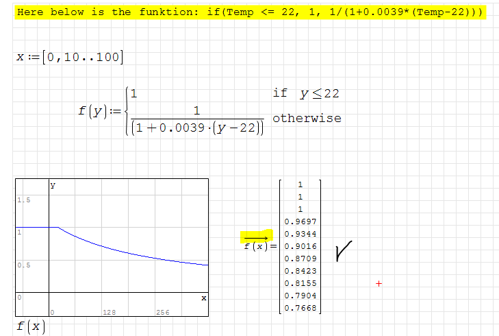

Hello everybody,
I use a beta-Version of SMath and have a question regarding the message:
"Type conversion error. Please contac the developer"

#2 Posted: 3/27/2019 9:08:34 AM
127 likes in 342 posts.
Do you want to get this result?
Problem_with_the_function_ser.sm (4.83 KiB) downloaded 1186 time(s).
#3 Posted: 3/27/2019 9:15:02 AM
Andrey
Andrey
1 likes in 44 posts.
Thank you very much, Sergio!
Yes, that's what I wanted to get.

#4 Posted: 3/27/2019 11:16:50 AM
Assign value for evaluation.
