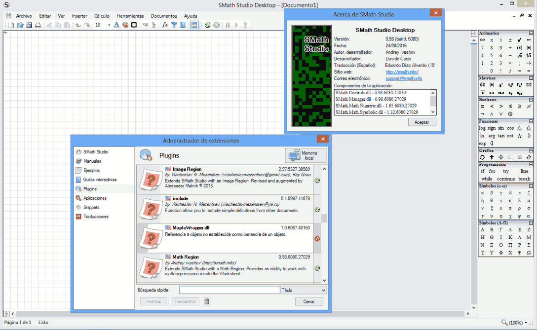

The same problem as I reported earlier.
The Maple plugin does not start when the Smath Studio program is changed into Spanish.

Windows version slows down on install, launch, file opening and calculation
Measured the time and I can confirm that the installer while updating is slower even for me (approx 20s vs 10s of previous versions); while installing after manual uninstall instead is faster than older versions (2s vs 4s). I have no issues on opening/calculation, but it might depends on installed plugins (there were a lot of changes in the APIs since 0.97, most of the plugins must be updated).
You can try the following if you won't execute the installer again:
  • download the latest linux version of Smath Studio on your windows machine
  • unpack it somewhere (important: do not create a portable version)
  • launch the command prompt in that folder and run
    SmathStudio_Desktop.exe -silent -i
  • for any plugin will be listed version and loading time, post it so we might see something
be sure to not have manually installed plugins in "{SS install path}\plugins" - won't be listed in the test above (in this case copy these plugins in the same location of the downloaded linux version before launching the prompt commands)
