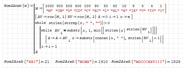

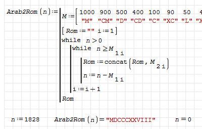

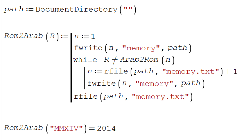

Really it's a very strange bahavior (a bug ?), because the value of variable n is cleared when function returns from Arab2Rom()
So, a solution is to use functions fwrite() and rfile() to save the value of n on a file as a memory:
See the atachment with the solution: Rome-Arab SOLVED.sm (41.21 KiB) downloaded 1374 time(s).
best,
Oscar
best,
Oscar

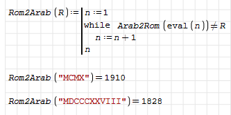

WroteThanks!
But this have an error too!
Rom2Arab.sm (293.29 KiB) downloaded 1378 time(s).

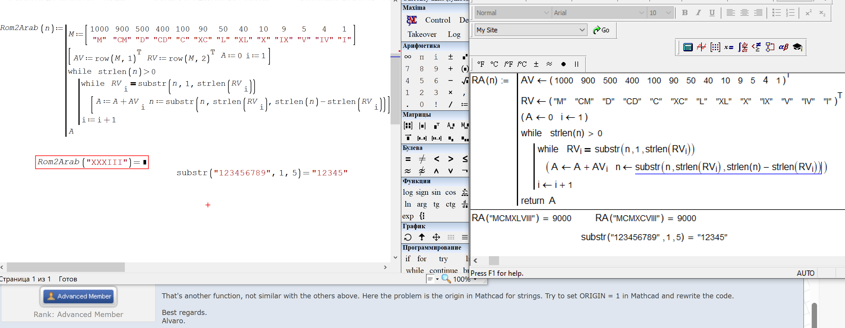

That's another function, not similar with the others above. Here the problem is the origin in Mathcad for strings. Try to set ORIGIN = 1 in Mathcad and rewrite the code.
