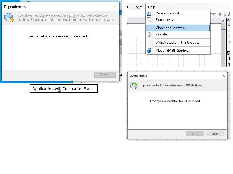

This is an annoying bug as it doesn't give you any context, it just closes the application after 3seconds of trying to update plugins (if you have sufficient plugin versions, it doesn't try to update, and it doesn't crash as a result:

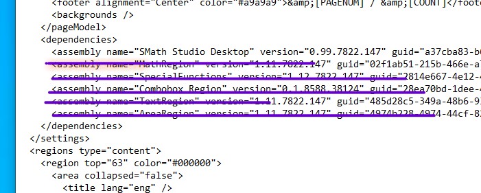

There is an easy work-around, just to delete (or correct) the plugin dependents within the SMath file you are accessing.

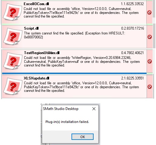

To the best of my knowledge, there are at lest (4) bad plugins that will not install:
  • "...\plugins\0370e95d-cfdf-4f76-96cb-468d63d765c0"
  • "...\plugins\a9f5e37d-83f5-4a4b-a106-0ba7b202abbb"
  • "...\plugins\e40eaef6-4622-4ef3-ad03-077e8f005bb1"
  • "...\plugins\20ad815b-bc5e-487d-9258-57fde2ac6de8"
I think the issue is that the program never addressed the possibility that a plugin that throws errors/doesn't work would ever be posted. As such, I believe that if ADMIN removes these (4) plugins from the online gallery, functionality of the 'checking for updates' will be restored:
May this be of Good Help;
⚜ Kenny Lemens, P.E. ᵂᴵ

Blow is an error message I captured before the crash. I cannot see much information, but it provides some context (i.e. an XML exception):
Show Spoiler
[FOLLOWUP]: I will concede, this may not be due to the plugins as the ability to check for updates on the software, or to access any of the online galleries contained within the Extensions Manager, will result in a crash. As such, disabling the (4) 'bad' plugins probably would have ZERO effect on addressing the underlining cause...
